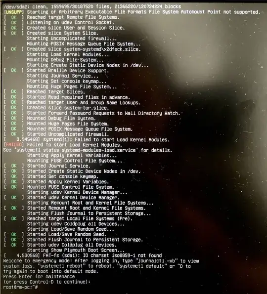

Yesterday I was watching a video on youtube and suddenly my laptop got frozen.
I wasn't able to even move my cursor, so I gave it 10 min and after no response, I pressed the shutdown button for 5 seconds and rebooted my machine.
When it rebooted, it presented me the following screen: enter image description here
Since than I've been searching the internet for any way to get pass this with absolute no luck.

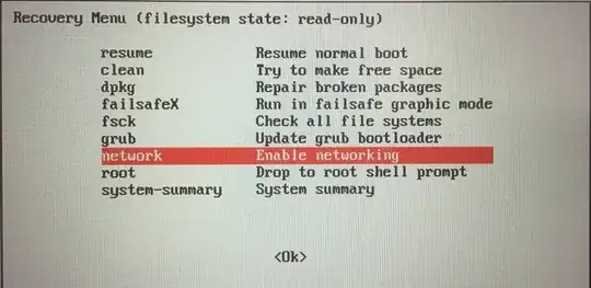

  • selecting the option Advanced options for Ubuntu
  • choosing the option Ubuntu, with Linux 4.4.0-66-generic (recover mode) enter image description here
  • selecting the option Enable networking from the Recovery Menu
  • when it finishes and returns to the Recovery Menu, I select the option Drop to root shell prompt
  • and then running the following commands with my Ethernet cable plugged in did the trick:

After all of that, my machine is still showing the screen in the first image. At this point I don't know what more can I try so I really need some light on this.

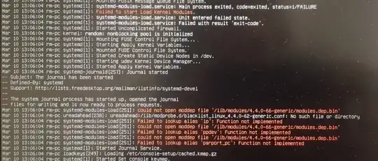

Also when I executed journalctl -xb and this are all the red lines in the code: enter image description here enter image description here enter image description here

I had this same issue. I had to go into the recovery mode for the 64 Kernel (65 was showing but it wouldn't let me do the apt-get update even after enabling networking) then enabling networking. Then I did an apt-get update and the dpkg --configure -a.
It stalled in the middle of that showing Loading Braille support... I had to press Ctrl+Z to get out of it and then do it again to finish. I think I did this 3 times before it finished unpacking and installing the 66 Kernel.
Once that was done I was able to boot it fine. Once in the GUI I was able to do another apt-get update, dpkg --configure -a and everything was fine. I also ran apt-get autoremove to get rid of all the old kernels. I'm back up again!
