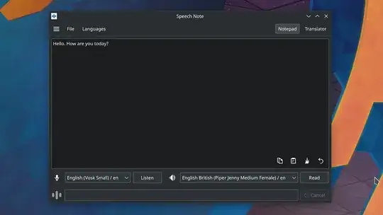

You can use Speech Note.
Note taking, reading and translating with Speech to Text, Text to Speech and Machine Translation
Speech Note let you take, read and translate notes in multiple languages. It uses Speech to Text, Text to Speech and Machine Translation to do so. Text and voice processing take place entirely offline, locally on your computer, without using a network connection. Your privacy is always respected. No data is sent to the Internet.
Screenshot
Installation
Probably the easiest way to install it on Ubuntu is to get it from Flathub:
Download on Flathub
