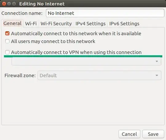

Under Unity, Network Manger has a check box available for every connection that configures the automatic use of a VPN when the connection is active:
Picture of Connection setting in ubuntu 16.06 Unity

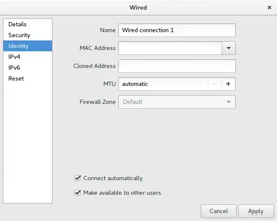

Is there a way to obtain an option like this in Ubuntu GNOME 16.04? (which uses GNOME 3.18). As the connection setting page lacks this option: enter image description here

I found the answer to this. Oddly, you have to open Network Manager manually (as opposed to using the panel or Settings.
So in Terminal type nm-connection-editor. After doing so, the window that opens will have the options in the OPs first image.
This works for me in 16.04 and 17.04. Hopefully, they will integrate the various network managers in upcoming versions of GNOME.
