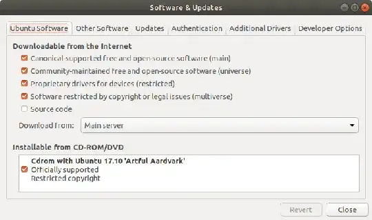

First, we need to enable universe repository. To do this, open Software and Update via application menu. Mark all universe repositories from the repo list.
software and updates
Click Reload to update Ubuntu. Next, use the following command to install Gnome Tweak Tool
 sudo apt install gnome-tweak-tool
