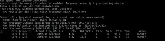

Phase 1
Before producing load. The frequency is high, in C7 state, and the fans are slow.

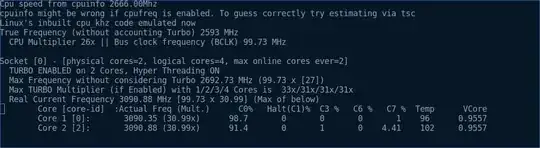

Phase 3
After like 30 seconds of heavy load, the CPU frequency remains high, the fans slow down for unexpected reasons, and the temperature continue to increase (probably because the fans slowed down)

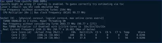

Phase 4
After some seconds at very high temperature (100-105°C, my CPU junction temp is 105), something decrease significantly the frequency and the temperature returns to an acceptable state. The fans are still slow.

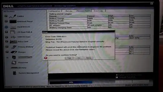

On boot I run Dell diagnostic tool and got the following:
(I made sure to give back control of fans to bios using sudo ./smm 30a3 because I disabled this)
This is a bit weird because I can clearly hear my fan speed goes up and down according to load so there must be something in control of it but I don't know what.
