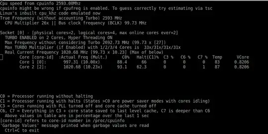

Under heavy-load i7z displays:
i7z
It says turbo mode is enabled, but the frequency is very low, and I'm sure for the exact same task (here compiling Scala code) the computer was much more noisy/fast before upgrading Ubuntu. Why does it happen?
