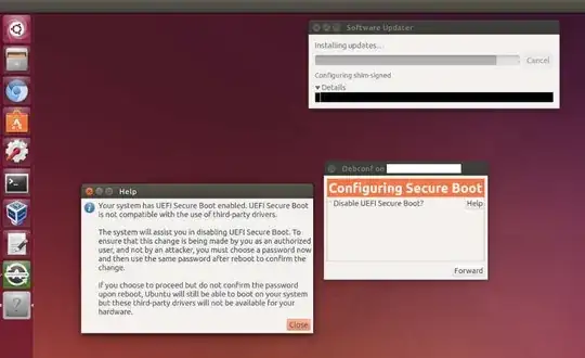

On 2016-07-15, I was applying updates as normal, or so I thought. The "Software Updater" pop-up window had got as far as "Configuring shim-signed", when I got this "Debconf" pop-up: Screenshot, whose contents are described at length in the accompanying text.
As you can see it:
  • says "Configuring Secure Boot" in large lettering
  • has a "Disable UEFI Secure Boot?" tick-box (check-box)
  • has a "Help" button
  • has a "Forward" button
I have never seen this before. I clicked on the "Help" button prior to taking the screenshot, which brought up the 3rd pop-up that you can see.
Help pop-up text
Just in case anyone searches by any of these phrases ...
Your system has UEFI Secure Boot enabled. UEFI Secure Boot is not compatible with the use of third-party drivers.
The system will assist you in disabling UEFI Secure Boot. To ensure that this change is being made by you as an authorized user, and not by an attacker, you must choose a password now and then use the same password after reboot to confirm the change.
If you choose to proceed but do not confirm the password upon reboot, Ubuntu will still be able to boot on your system but these third-party drivers will not be available for your hardware.

You are correct. The Canonical Kernel Team has enabled EFI_SECURE_BOOT_SIG_ENFORCE in the new 3.19 Ubuntu kernel.
That prevents from loading unsigned 3rd party kernel modules.
It looks like there is a script with GUI that is supposed to help to disable Secure Boot.
It did not work in your case. It depends on specific UEFI implementation in your computer.
But you can simply disable Secure Boot in your UEFI settings.
See this answer and comments below.
Pilot6
  • 92,041
You can also disable Secure Boot running sudo update-secureboot-policy. This wiki page explains this method.
