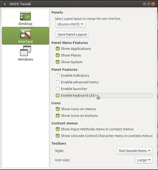

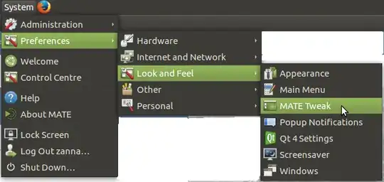

It turns out that MATE-Tweak, built into the default installation of Ubuntu MATE, has an option to enable keyboard LED indicators
Under Interface, check the box Enable keyboard LED
And now you have three key lock icons in your indicator panel - one for each key. Here's what it looks like when Caps Lock is on but the other locks are off:

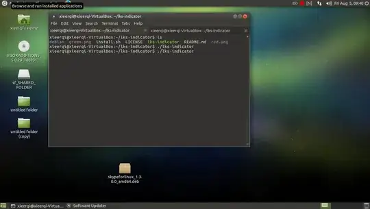

Indicator in action
As you can see below, the indicator displays green icon and which key is currently active. When no keys are engaged, the icon remains green
