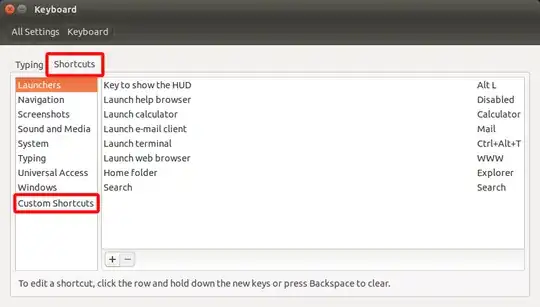

If these work, you can get the function keys to change brightness by assigning them as shortcuts to the commands.
In keyboard settings click Custom Shortcuts and click the + button to add a new one
Command: xbacklight -inc 15
Click OK, then click where it says 'Disabled' next to the new shortcut and press the key combination you want (Fn will probably not work) for example ctrl+F6 or just F6
Command: xbacklight -dec 15
And make this one F5 or whatever combination you want.

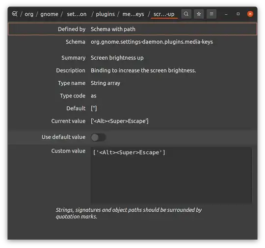

I am on 20.04 and I used dconf-editor to adjust the screen brightness from keyboard shortcuts.
Open dconf-editor and search for screen-brightness-up and screen-brightness-down, and under custom-value change the value to the shortcut you want to set (will tell later how to know what to enter).
I don't know the exact syntax followed by dconf-editor, but I will tell you how to find the syntax. Head over to settings > Keyboard shortcuts. Now search for volume up, and choose the shortcut which you want to use for screen brightness up. Then head over to dconf editor and search for volume-up, and now see the string in the custom value for volume-up, and now copy paste this string to the screen-brightness-up > custom value field. We have to do this as we can access the shortcuts for volume and not for brightness.
So we manipulate the value for volume from settings and then use that value for screen-brightness-up in the dconf editor. And then remove that custom value from dconf-edtor for volume-up (or set it back to its previous value).
Hope this helps. I was finding this for a very long time and the other answer didn't work for me, but I was finally able to figure this hack out, and hopes this helps many other people.
