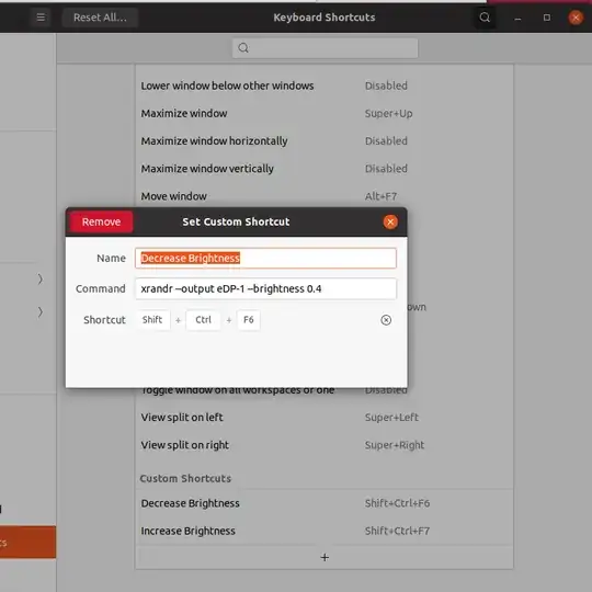

However, unlike the KDE desktop, the default version of Ubuntu does not have the brightness change option as one of the default keyboard shortcuts, and therefore, I will have to type the command myself. I have tried doing this, but I am not satisfied with the result.
When I remap the keyboard shortcut on KDE, I am able to incrementally increase the brightness as I wish. But in the default version of Ubuntu, with the commands I have put in, I am only able to set a Low brightness, and a High brightness. I can set nothing in between.
This might be due to my limited knowledge. May I know if there is an approach in which I can set a command to incrementally increase brightness, and another to incrementally decrease brightness? In other words, is there a command I can enter such that the brightness is decreased or increased by 0.1 points?

Brightness changing command testing
