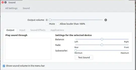

I have noticed that this problem has been asked about many times but none of the answers that I have seen so far work for me.
Today in the morning I went to my computer and tried listening to some music but there was no sound. At first I just thought that volume was low or that it was muted but when I tried to turn up the volume it didn't work. I tried looking around the Internet for solutions but sadly nothing works.
Screen Shot of Volume menu:
Click here to see the screen shot

It appears that that there is a bug report filed for this which might or might not be related to Skype.
The problem
The error message mentions that there's a problem with a PulseAudio module.
Solution 1: disabling the module
If you'd like to try disabling the module, which might make Bluetooth audio not work, open a terminal (press Ctrl+Alt+T), and run the following:
sudo sed -i 's/^load-module module-bluetooth-policy/#load-module module-bluetooth-policy/' /etc/pulse/default.pa
sudo service pulseaudio restart
sleep 15
pulseaudio -k
pulseaudio --start
pavucontrol
If the PulseAudio volume control shows up properly, you should have sound.
Reenabling the module
If that doesn't fix it, open a terminal and run:
sudo sed -i 's/^#load-module module-bluetooth-policy/load-module module-bluetooth-policy/' /etc/pulse/default.pa
sleep 15
pulseaudio -k
pulseaudio --start
Solution 2: reinstalling the Bluetooth module
If you'd like to try reinstalling Ubuntu's version of the module, which might make Skype not work, open a terminal (press Ctrl+Alt+T) and run:
sudo apt update
sudo apt install --reinstall pulseaudio-module-bluetooth
sleep 15
pulseaudio -k
pulseaudio --start
pavucontrol
