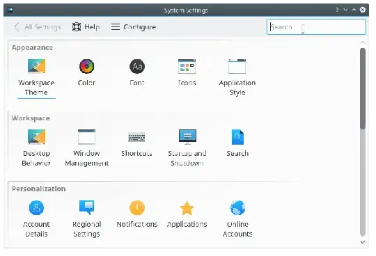

KDE System Settings > Personalization - Applications > Launch Feedback

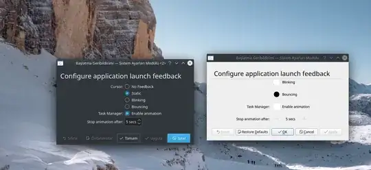

When I type the command "# kcmshell5 launchfeedback" to the terminal to change my mouse animation, a white window was opened. And the "launch feedback" that I found by searching for the word "launch" in the start menu is the dark window. It says "system settings module" in the window titles. Someone has the phrase <2>. And the window that says <2> is the correct one. Somehow Static was chosen by itself. And I didn't change that. Somehow it happened by itself. Also, I don't know why there were 2 of these modules.
