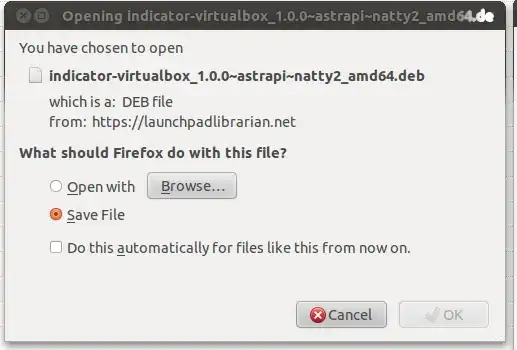

When I download a file with firefox, it always asks me with what program I want to open it with, even when that type of file is recognized by the system, and I can double click on it in Nautilus and have it open properly.
This is an example with a deb file, which opens with Ubuntu Software center (as it should) when I double click on it in Nautilus.
I do not want to look for the required program in /usr/bin or whatever in the Firefox dialog, I want Firefox to recognize my system preferences. What I resort to doing now is choose "Download", open Nautilus and double click on the file...
Why can't Firefox recognize my system settings, and how do I get it to?

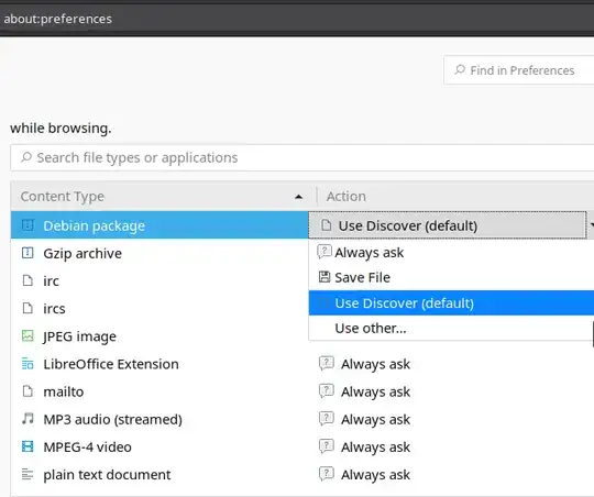

There are different settings involved here:
  • What program Firefox proposes when downloading a file (as in the image posted in the question)
  • What program Firefox uses when accessing an online file
  • What program opens a file already downloaded when clicked in the Firefox downloads list.
For the first two options, the "Applications" settings under Preferences/Options (about:preferences as address) should do the trick (if it doesn't it is a bug and it should be reported as such).
Example for a deb file:
If the setting is to save, the file will be saved in Downloads or a selected location; if the setting is to open with an application, the file will be first saved anyway in a temporary location and then opened. If no program appears selected upon download try the above setting; if that doesn't work, try the below solution.

You should go to EditPreferencesApplications and decide what Firefox should do with every kind of files available. You can choose it to open with a certain application or to ask what to do.
That's the easiest, one click-way of doing it. Or you can use the dialog that appears (an that you have showed here), choose an application to open it and enable Do this automatically for files like this from now on. Next time you open one of these files it won't ask you again.
But I recommend the first solution.
