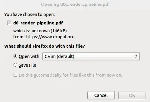

Whenever I click a download link in Firefox (Ffox 38, on Ubuntu 12.04LTS) such as a PDF, I get
screenshot 1
And there's nothing more sensible than GVim in the Open With menu.

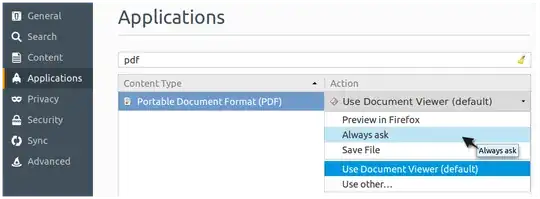

When I look in about:preferences, I see
screenshot 2
Which seems to imply it's aware of a document viewer application, but then it's not giving me that option when it opens a PDF...?
I've used PDF here as an example, it's the same with other formats, e.g. it also offers to open tar files with Gvim...
How can I get Firefox 38 to correctly populate the Open with drop-down?

By using " xdg-mime " you should be able to change the default application from browsers. Please look at this link for more info.
EDIT: I wrongly pasted some comments here (Thanks artfulrobot for pointing that). Removed them now. Please look at the link mentioned above for changing the application preference.
Delete or rename your mimeTypes.rdf file, then restart Firefox. The mimeTypes.rdf file will be located somewhere in the ~/.mozilla directory.
