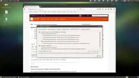

My problem is that even though I have the drivers installed, as in this picture:
Ubuntu still doesn't use them. I don't know why.

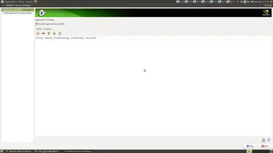

When I write nvidia-settigs I get this:
I Think I have problem with x-org, as if the drivers are not in use. I've tried purging the xorg-* but no use and then:
