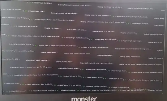

While switching from nvidia GPU to intel GPU, I'm not having any problems. When nvidia is on, I can easily reboot, suspend, sleep, poweroff. But when I'm on intel GPU, I can do none of those. It always freezes and I have to hold on the power button to force close it. If it sleeps, it won't wake up and so on. Same problem occurs if I use terminal commands (such as sudo reboot) to do these too.

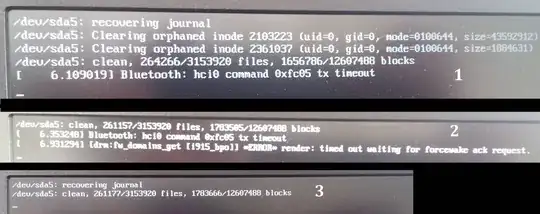

It stays like one of these. And nothing happens: It stays like one of these. And nothing happens.
The cursor doesn't blink. Screen is completely frozen.
I've removed "quiet splash" from grub to see what's wrong in more details, but it gave something like this, which, doesn't tell much.
