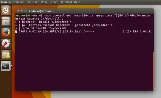

I sacrificed a VM using a slightly more advanced usage of dd borrowed and slightly modified from the Arch Wiki pages.
First install a nice progress meter:
sudo apt-get install pv
And then run the 'enhanced' dd command
sudo openssl enc -aes-256-ctr -pass pass:"$(dd if=/dev/urandom bs=128 count=1 2>/dev/null \
| base64)" -nosalt </dev/zero \
| pv -bartpes "$(sudo blockdev --getsize64 /dev/sda)" \
| sudo dd bs=64K of=/dev/sda
This will leave the disk filled with AES ciphertext. A complete and secure disk wipe? Probably better than your own dd example but nothing is completely safe or guaranteed...
And you owe me one VM :)
