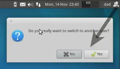

In a terminal:
sudo apt-get install xfswitch-plugin
During installation it will ask you to switch window manager - do not choose GDM, but stick with lightdm. N.B. since its a text screen press TAB to navigate to "OK" and press ENTER
Right-click and add a new panel item - User Switching
