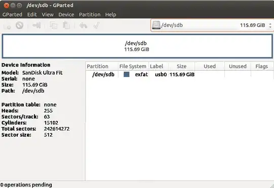

Briefly, your drive still has a partition table and the file system type shows up correctly as exFAT, as seen on your screenshot. Install TestDisk and run it on the device:
sudo apt install testdisk
sudo testdisk /dev/sdb
