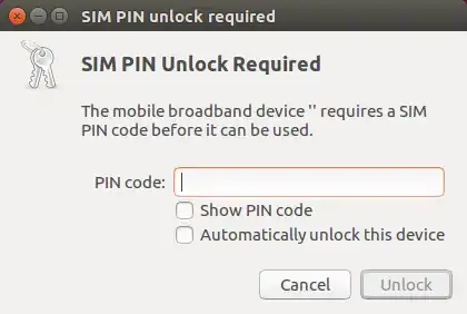

I tried with a new Ubuntu 16.04 UEFI and updated my BIOS to latest version, now it works like plug'n play. I had a too old installation with too many fixes and changes, now it just works. Thanks!
