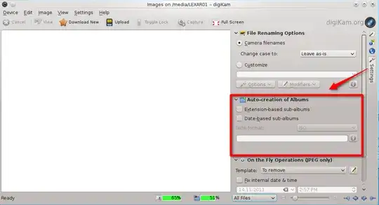

If your camera provides information about the date of the photograph's taking, digiKam can use this to automatically create subalbums in the destination Album when it is downloaded...
Plug in a device. The digiKam import window has the settings for the "Auto Creation of Albums"

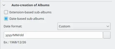

In recent versions of digiKam you can create multiple levels of sub-albums by using / in a custom date format:
auto-create sub-albums with date format "yyyy/MM/dd"

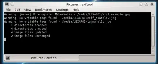

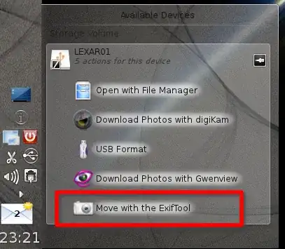

Testing with few pictures
Now there is a new option: Move with the ExifTool.

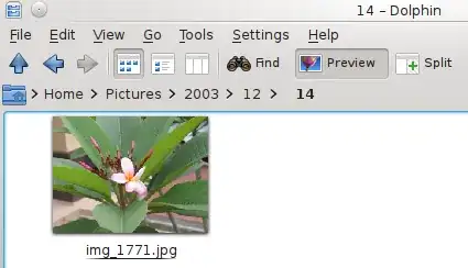

The Device Action is showing the success/failure with the terminal:
The sub directories have the /YYYY/MM/DD format
