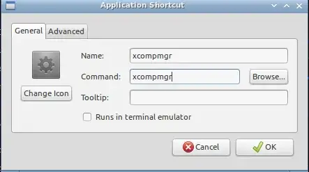

First create the autostart folder if it doesnt already exist:
mkdir -p ~/.config/autostart
Then create a xcompmgr desktop file
lxshortcut -o ~/.config/autostart/xcompmgr.desktop
logout and login.

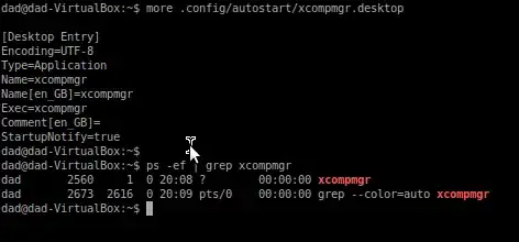

N.B. this picture shows what the xcompmgr.desktop file contains as well how to confirm xcompmgr is running.
