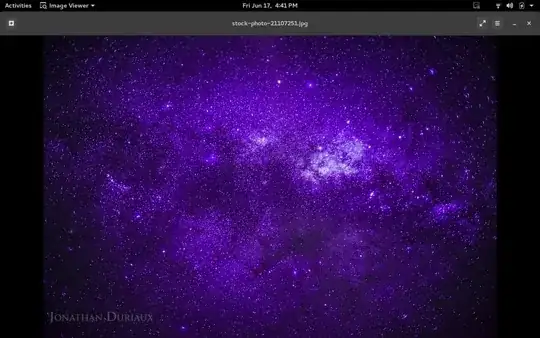

When I open an image file in eog it displays the wrong color.
Here is a screenshot of the problem:

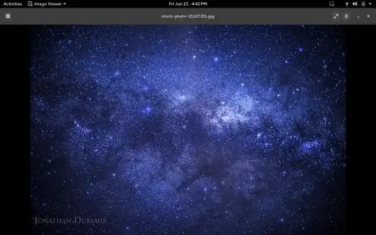

And here is a screenshot of the problem temporarily fixed:
by using
xprop -root -remove _ICC_PROFILE
What I wanted to know is there a permanent way of fixing the problem instead of fixing it every time I open eog.
