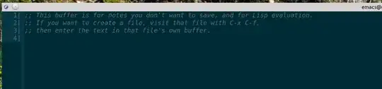

I am using Emacs on Kubuntu. On startup, I maximize my Emacs frame with this command in my init.el:
(custom-set-variables
 '(initial-frame-alist (quote ((fullscreen . maximized)))))
This works, but leaves a small gap around the not quite maximized frame as you can see here:
Gap around a 'maximized' Emacs frame.
Is there a way to completely maximize Emacs and remove this gap?
