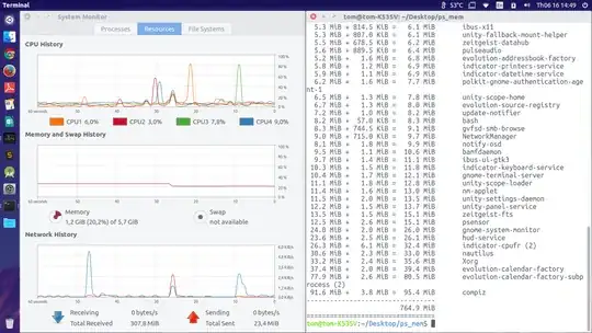

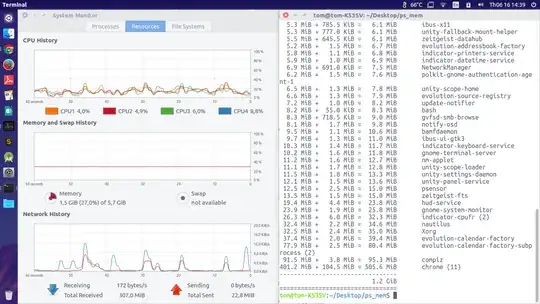

Then I use a terminal tool to check for memory ( I use ps_mem here) - and the memory here is significantly lower than which showed in System Monitor:
Memory with no apps
Memory with 5 chrome tabs opended

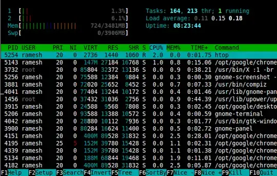

I monitor memory usage by application using htop
sudo apt-get update
sudo apt-get install htop
then run by
htop
to get this output:
The controls are intuitive enough that I use it with F6SortBy to decide whether I am more interested in memory or CPU%
Here is an article that shows more advanced ways to use htop
Top on Steroids – 15 Practical Linux HTOP Examples
