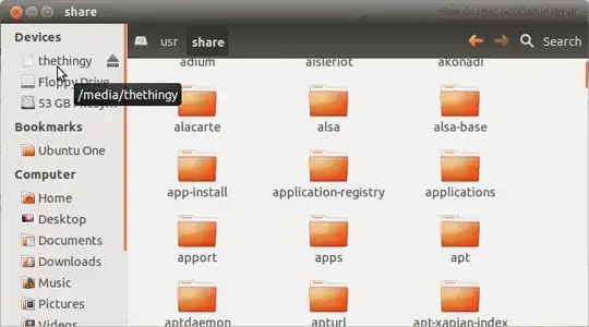

This may sound dumb but have you tried right-clicking on the icon? Otherwise try open homefolder and click on the mounted icon to the left.
like on this picture
Hope it helps!
Leo
