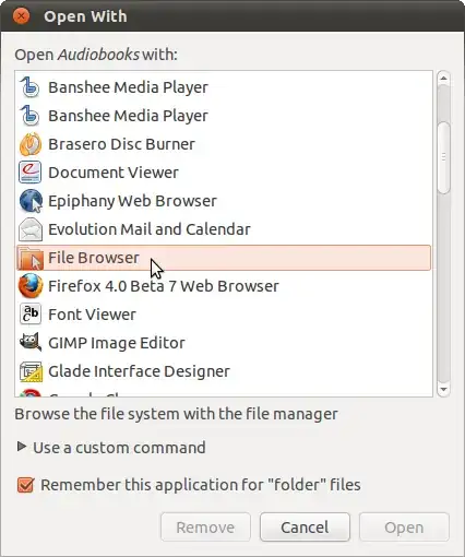

You are probably seeing this bug. You need to open Nautilus, right click on a folder, and go to the Open With Other Application... in the right click menu and set it back to File Browser
Don't forget to make sure the checkbox for "Remember this application for folder files" is checked!
