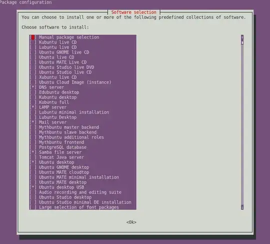

Which will show you a window similar to the one in following screen-shot:
Move your selector to the LAMP entry and press space to mark it, then press tab to highlight the <ok> field and press return. This starts the installation process.

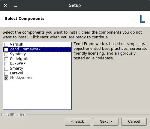

  • Download the recommended installer from here : https://bitnami.com/stack/lamp/installer
  • Provide execution permission to the *.run file that you download
    chmod +x bitnami-lampstack-xxx-xxx-xxx.run
  • Run it. (Just double click on it or run from terminal : ./binnami-xxx.run)
  • The installation processes is self explanatory.

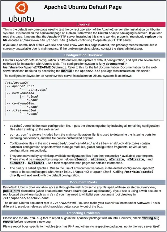

You can do a spot check right away to verify that everything went as planned by visiting your server's public IP address in your web browser (see the note under the next heading to find out what your public IP address is if you do not have this information already):
http://your_server_IP_address (or just type localhost in URL bar)
You will see the default Ubuntu 16.04 Apache web page, which is there for informational and testing purposes. It should look something like this:
If you see this page, then your web server is now correctly installed and accessible through your firewall. How To Find your Server's Public IP Address

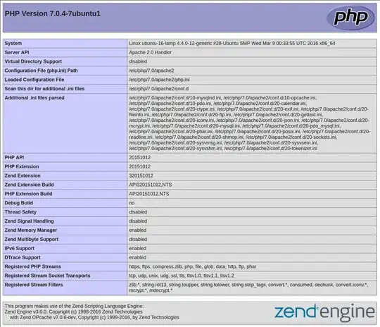

Now we can test whether our web server can correctly display content generated by a PHP script. To try this out, we just have to visit this page in our web browser. You'll need your server's public IP address again.
The address you want to visit will be:
http://your_server_IP_address/info.php (or localhost/info.php)
The page that you come to should look something like this:
This page basically gives you information about your server from the perspective of PHP. It is useful for debugging and to ensure that your settings are being applied correctly.
If this was successful, then your PHP is working as expected.
