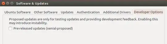

Is there any reason why I shouldn't enable proposed updates for Ubuntu before Ubuntu is released as stable?
Are proposed updates different after a stable Ubuntu release?
screenshot of proposed updates options screen from software-properties-gtk
