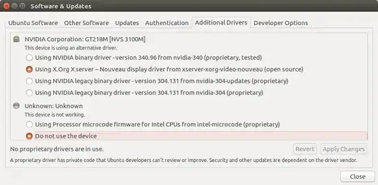

Update: Driver status screenshot

use the NVIDIA proprietary drivers listed in the screenshot you provided. Choose the top choice: NVIDIA binary driver - version 340.96 from nvidia-340
