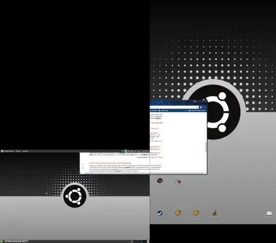

  1. My desktop icons are all on my secondary display and I can't move them back.
  2. I can no longer maximize windows on my primary display by dragging them to the top of the screen, this results in them being dragged to a desktop with no display that shouldn't be an accessible area anyway.
  3. After hours of searching for solutions, I was finally able to write a script that will create and assign the proper resolution and position to my secondary display, and leave it alone if it isn't connected. The catch there is that I have to log in first, so prior to login I am stuck with a sideways login screen that is, oddly enough, on my secondary display.
I am using an older VAIO laptop with a VGA output (hence the need to create the proper resolution for my external monitor) and running Ubuntu MATE 16.04.
Here's a screen shot:
Monitor layout, icons, and example of window problem

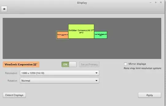

I fixed this in in Display settings (System Settings --> Display). The three monitors I use are different sizes, but after dragging the monitors so that they were aligned along the bottom axis, my icons returned my primary monitor on the left
Like this

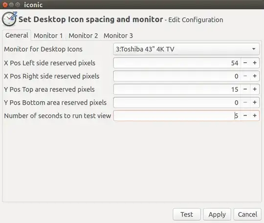

I wrote the iconic script to give control over which monitor icons are placed on. It also ensures icons don't get placed into the "black hole" that exists when monitors of different resolutions are used.
Here are a few screenshots of iconic to give you an idea of how it works.
iconic Monitors Notebook General Tab screenshot
On this notebook tab you can also specify the number of seconds a test will last. Press the Test button to place icons on the Desktop using currently defined each time you change the reserved screen space.

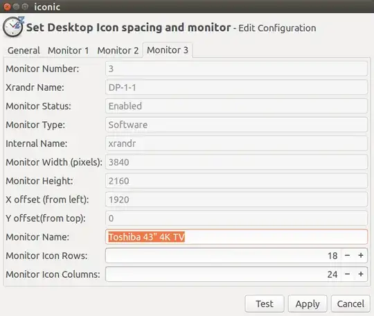

iconic Monitors Notebook Monitor 3 tab
Assign a user friendly name to each monitor. Set the number of rows and columns to utilize for icon placement on each monitor.
Use the Test button to view what icon placement after number or columns and/or rows are changed.
