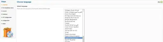

To start the installation of Joomla, on another desktop:
http://IP OF YOUR SERVER/joomla

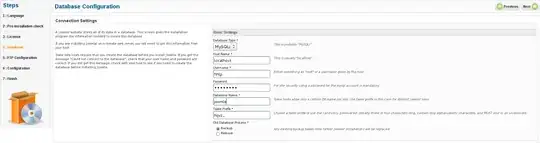

Then follow the setup wizard. At the Database Configuration page, provide the MySQL settings we have already created:
  • Database Type : MYSQL
  • Host Name : Localhost
  • Username: your username in sql step
  • Password: the selected password
  • Database Name: joomla
  • Table Prefix : Aleatory
  • Save and close.

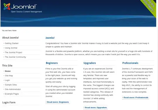

When you reach the final screen with congratulations on installing Joomla!, you should remove the installation directory. From root terminal:
rm -rf /var/www/joomla/installation/
