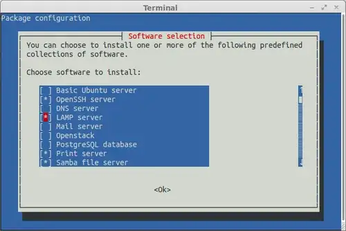

or you can install lamp server using command tasksel then select LAMP Server
sudo apt-get install tasksel
sudo tasksel

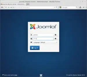

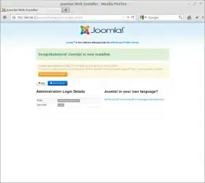

Now you can install joomlo 3.0 from your favorite browser by typing http://[hostname]/joomla, see screenshot below
