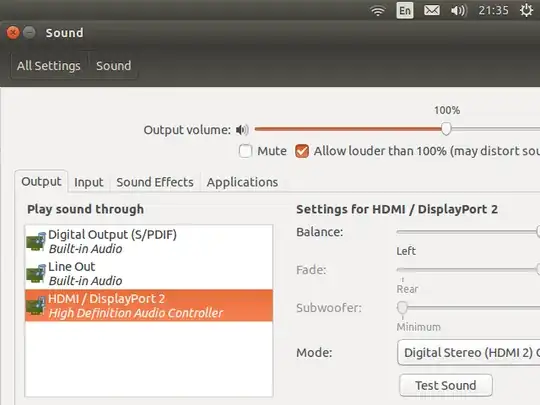

I will try to help you. It sounds like your HDMI is working ok, but try this if you haven't already.
  1. First, plug in your HDMI cable.
  2. Go to settings and click on Displays.
    Displays
3.Now click on Mirror Displays.
  1. Finally, click on apply.
That does it for the video. Now you'll want to adjust the audio so that you hear it from you television.
  1. Click on the volume control on the top right hand corner of the monitor.
volume
  1. Now scroll down to Sound Settings. You should see this screen:Sound_Settings
  2. Click on the HDMI menu in your sound settings and you are good to go.
I hope this helps.
