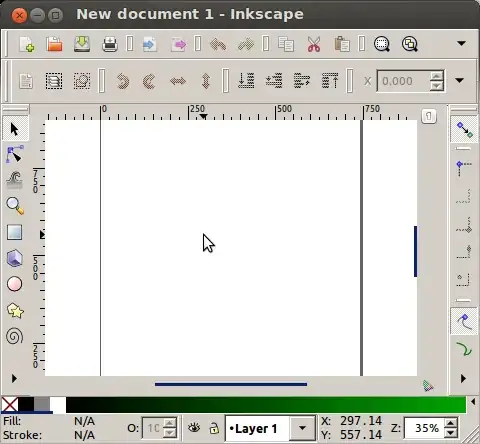

Yes, the simple way is to point the application at the required path where your rc file lives, in the command that runs your application:
GTK2_RC_FILES=/usr/share/themes/Redmond/gtk-2.0/gtkrc inkscape
This on 12.04 for inkscape (which is still Gnome2 btw) produces this:
inkscape window with windows theme
See more information about Gtk2 theme running here.
