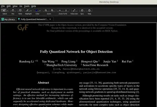

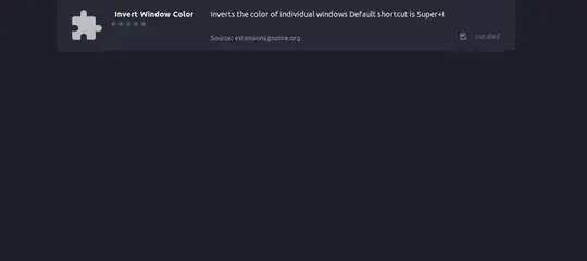

A little update here: A quick update solution to read in dark mode in Ubuntu now is using Gnome Extension Inverted Color.
Then, you can toggle the application screen between dark and light by Super + I
