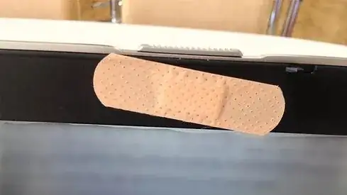

A foolproof way to block webcam input
Webcam blocker
Picture provided by Darkreading.com
