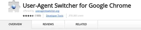

I have the simplest and easiest solution. Just install "User-Agent Switcher for Google Chrome" from Chrome web store.
After Installing the extension Click on the extension...

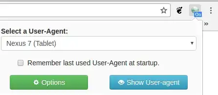

Then Select the "Nexus 7 Tablet" option.
Now you are good to go guys. Hotstar will buffer the videos but always check if the extension is turned on and selected as "Nexus 7 Tablet" option.

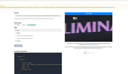

Step 1: Open below
http://demo.jwplayer.com/developer-tools/http-stream-tester/
Step 2: Open Hotstar video link
http://www.hotstar.com/movies/escape-plan/1000074645/watch
Note: ID = 1000074645
Step 3: Open link below
http://getcdn.hotstar.com/AVS/besc?action=GetCDN&asJson=Y&channel=TABLET&id=123&type=VOD
Step 4: Replace url id=123 to id=ID as
http://getcdn.hotstar.com/AVS/besc?action=GetCDN&asJson=Y&channel=TABLET&id=1000074645&type=VOD
Output will be:
{"errorDescription":"200","message":"200","resultCode":"OK","resultObj":{"checkCacheResult":"","height":"360","src":"https://staragvod1-vh.akamaihd.net/i/videos/movies/hindi/1000074645/1000074645_,16,180,400,800,1300,2000,_STAR.mp4.csmil/master.m3u8?subtitle_identifier=1000074645&hdnea=st=1495051740~exp=1495052340~acl=/*~hmac=e9a791981ee7b95fa74d673db688d488f1416df5403165e3608987b3a12a19c0","width":"480"},"systemTime":1495052040}
Step 5: Take "src" out of it
src = https://staragvod1-vh.akamaihd.net/i/videos/movies/hindi/1000074645/1000074645_,16,180,400,800,1300,2000,_STAR.mp4.csmil/master.m3u8?subtitle_identifier=1000074645&hdnea=st=1495051740~exp=1495052340~acl=/*~hmac=e9a791981ee7b95fa74d673db688d488f1416df5403165e3608987b3a12a19c0
Step 6: Put src in File url: adding place and hit Test Stream
Note: Open everthing in different tabs
It will work definately. In case of error repeat it.

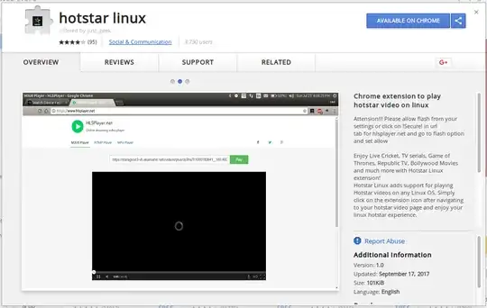

  1. Install and open Google Chrome (Chromium will not work as flash is required).
  2. Go to Google Chrome webstore and install hotstar linux plugin.
  3. Restart Google Chrome.
  4. Go to www.hotstar.com and play a video. It will not start playing.

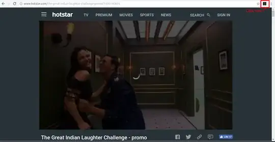

  5. Click on the hotstar linux icon on the top right corner.

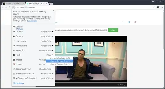

    A new tab opens and takes to https://www.hlsplayer.net/.
  6. Click on i icon at the start of the url in the url bar. Allow flash for https://www.hlsplayer.net/.
    If the video still does not start playing, close the tab and go back to www.hotstar.com. Again click on the top right icon for hotstar linux. It should start playing now.
