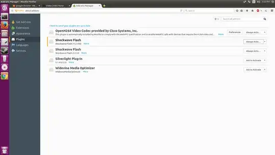

Finally, you must add the plugins to Firefox.
sudo pipelight-plugin --create-mozilla-plugins
Testing it out!
If done correctly, Pipelight should have installed an update version of Flash, Silverlight, and Widevine, which it runs through Wine, as can be seen in the Plugins section of the Add-ons Manager.
Firefox plugins with up to date Flash, Silverlight and Widevine

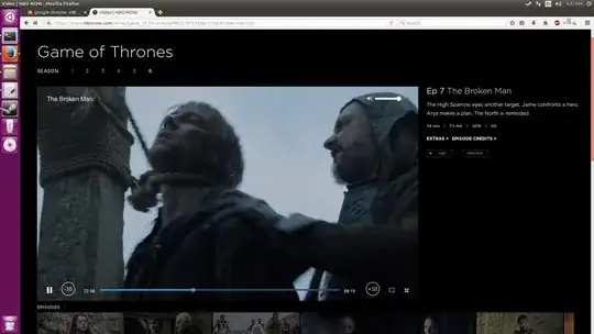

Finally, open up Firefox and test 'er out.
HBO NOW on Ubuntu

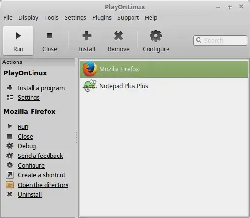

Pipelight solution does not work at the moment, but Firefox with Flash on PlayOnLinux does.
  1. Install and run PlayOnLinux
sudo apt install playonlinux
playonlinux
  1. Click Install and search for Firefox
  1. Select Flash when prompted
  2. Run Firefox
  1. Go to HBO website and if the videos still do not work, install the Flash they link to.
