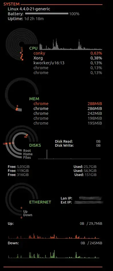

Conky changed the conkyrc format to lua in the recent versions, the original seamod (and 99% of all other conkys out there) still have the old format.
Thankfully, user maxiwell on Github has already converted the popular seamod theme for Ubuntu 16.04. Since askubuntu/Stackoverflow prefers source instead of links, here the conkyrc.lua:
--                               conkyrc_seamod
-- Date    : 04/23/2016
-- Author  : SeaJey and Maxiwell
-- Conky   : >= 1.10
-- License : Distributed under the terms of GNU GPL version 2 or later
conky.config = {
    background = true,
    update_interval = 1,
    cpu_avg_samples = 2,
    net_avg_samples = 2,
    temperature_unit = 'celsius',
    double_buffer = true,
    no_buffers = true,
    text_buffer_size = 2048,
    gap_x = 80,
    gap_y = 70,
    minimum_width = 300, minimum_height = 900,
    maximum_width = 350,
    own_window = true,
    own_window_type = 'override',
    own_window_transparent = true,
    own_window_argb_visual = true,
    own_window_class = 'conky-semi',
    own_window_hints = 'undecorated,sticky,skip_taskbar,skip_pager,below',
    border_inner_margin = 0,
    border_outer_margin = 0,
    alignment = 'top_right',
    draw_shades = false,
    draw_outline = false,
    draw_borders = false,
    draw_graph_borders = false,
    override_utf8_locale = true,
    use_xft = true,
    font = 'caviar dreams:size=11',
    xftalpha = 0.5,
    uppercase = false,
-- Defining colors
    default_color = '#FFFFFF',
-- Shades of Gray
    color1 = '#DDDDDD',
    color2 = '#AAAAAA',
    color3 = '#888888',
-- Orange
    color4 = '#EF5A29',
-- Green
    color5 = '#77B753',
-- Loading lua script for drawning rings
    lua_load = '~/.conky/seamod/seamod_rings.lua',
    lua_draw_hook_pre = 'main',
--${offset 15}${font Ubuntu:size=11:style=normal}${color1}${pre_exec lsb_release -d | cut -f 2} - $sysname $kernel
conky.text = [[
${font Ubuntu:size=11:style=bold}${color4}SYSTEM ${hr 2}
${offset 15}${font Ubuntu:size=11:style=normal}${color1}$sysname $kernel
${offset 15}${font Ubuntu:size=11:style=normal}${color1}Battery:  ${color3}${battery_bar 5,150 BAT0} ${color3}${battery_percent BAT0}%
${offset 15}${font Ubuntu:size=11:style=normal}${color1}Uptime: ${color3}$uptime
# Showing CPU Graph
${voffset 20}
${offset 125}${cpugraph cpu0 40,220 666666 666666 -0.5 -l}${voffset -25}
${offset 90}${font Ubuntu:size=11:style=bold}${color5}CPU
# Showing TOP 5 CPU-consumers
${offset 105}${font Ubuntu:size=11:style=normal}${color4}${top name 1}${alignr}${top cpu 1}%
${offset 105}${font Ubuntu:size=11:style=normal}${color1}${top name 2}${alignr}${top cpu 2}%
${offset 105}${font Ubuntu:size=11:style=normal}${color2}${top name 3}${alignr}${top cpu 3}%
${offset 105}${font Ubuntu:size=11:style=normal}${color3}${top name 4}${alignr}${top cpu 4}%
${offset 105}${font Ubuntu:size=11:style=normal}${color3}${top name 5}${alignr}${top cpu 5}%
#Showing memory part with TOP 5
${voffset 40}
${offset 90}${font Ubuntu:size=11:style=bold}${color5}MEM
${offset 105}${font Ubuntu:size=11:style=normal}${color4}${top_mem name 1}${alignr}${top_mem mem_res 1}
${offset 105}${font Ubuntu:size=11:style=normal}${color1}${top_mem name 2}${alignr}${top_mem mem_res 2}
${offset 105}${font Ubuntu:size=11:style=normal}${color2}${top_mem name 3}${alignr}${top_mem mem_res 3}
${offset 105}${font Ubuntu:size=11:style=normal}${color3}${top_mem name 4}${alignr}${top_mem mem_res 4}
${offset 105}${font Ubuntu:size=11:style=normal}${color3}${top_mem name 4}${alignr}${top_mem mem_res 5}
# Showing disk partitions: root, home and files
${voffset 12}
${offset 180}${color1}${font Ubuntu:size=10:style=bold}Disk Read: ${alignr}${font Ubuntu:size=10:style=normal}${color2}${diskio_read}
${offset 180}${color1}${font Ubuntu:size=10:style=bold}Disk Write: ${alignr}${font Ubuntu:size=10:style=normal}${color2}${diskio_write}
${voffset -30}
${offset 90}${font Ubuntu:size=11:style=bold}${color5}DISKS
${offset 120}${diskiograph 33,220 666666 666666}${voffset -30}
${voffset 20}
${offset 15}${font Ubuntu:size=10:style=bold}${color1}Free: $color3${font Ubuntu:size=10:style=normal}${fs_free /}${alignr}${font Ubuntu:size=10:style=bold}${color1}Used: $color3${font Ubuntu:size=10:style=normal}${fs_used /}
${offset 15}${font Ubuntu:size=10:style=bold}${color1}Free: $color3${font Ubuntu:size=10:style=normal}${fs_free /home}${alignr}${font Ubuntu:size=10:style=bold}${color1}Used: $color3${font Ubuntu:size=10:style=normal}${fs_used /home}
${offset 15}${font Ubuntu:size=10:style=bold}${color1}Free: $color3${font Ubuntu:size=10:style=normal}${fs_free /media/files}${alignr}${font Ubuntu:size=10:style=bold}${color1}Used: $color3${font Ubuntu:size=10:style=normal}${fs_used /media/files}
# Network data (my desktop have only LAN). ETHERNET ring is mostly useless but looks pretty, main info is in the graphs
${voffset 40}
${offset 200}${font Ubuntu:size=10:style=bold}${color1}Lan IP: ${alignr}$color3${addr wlan0}
${offset 200}${font Ubuntu:size=10:style=bold}${color1}Ext IP: ${alignr}$color3${execi 3600 wget -q -O /dev/stdout http://checkip.dyndns.org/ | cut -d : -f 2- | cut -d \< -f -1}
${voffset -30}
${offset 90}${font Ubuntu:size=11:style=bold}${color5}ETHERNET
${voffset 40}
${offset 15}${color1}${font ubuntu:size=10:style=bold}Up: ${alignr}${font Ubuntu:size=10:style=normal}$color2${upspeed wlan0} / ${totalup wlan0}
${offset 15}${upspeedgraph wlan0 40,320 4B1B0C FF5C2B 1280KiB -l}
${offset 15}${color1}${font Ubuntu:size=10:style=bold}Down: ${alignr}${font Ubuntu:size=10:style=normal}$color2${downspeed wlan0} / ${totaldown wlan0}
${offset 15}${downspeedgraph wlan0 40,320 324D23 77B753 1280KiB -l}
${color4}${hr 2}

This should give you the original seamod appearance backSeamod on 16.04.
All credit goes to user maxiwell from Github.

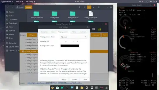

Use an updated seamod and try set window type to dock or normal
On Ubuntu Gnome 16.04, maxiwell's update of seamod worked for me (as mentioned by emk2203's answer), but provided I edited the conkyrc.lua to use the 'dock' or 'normal' window type and use window manager hints. E.g the following are key config values to use:
own_window_type = 'dock',
own_window_type = 'normal' with the above own_window_hints also worked okay.
Beware, maxiwell's conkyrc.lua has a typo where own_window_type is set twice. Remove the duplication if you use it.
What didn't work:
  • own_window_type = 'desktop' doesn't work well as conky disappears when clicking desktop items.
  • own_window_type = 'override' causes X Error of failed request: BadMatch (invalid parameter attributes) in Ubuntu Gnome and also doesn't support background transparency.
And of course, it needs the conky-all package, not conky-std, as seamod depends on cairo to draw the gauges/rings.
