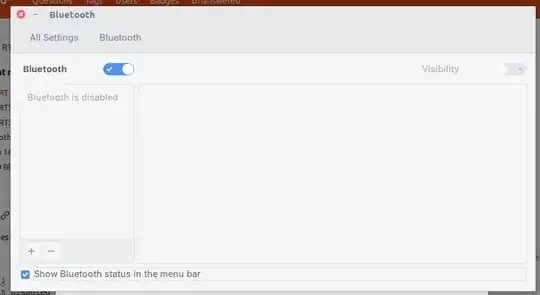

I have wifi and Bluetooth modules RT3290. Wifi is working fine but Bluetooth is shown as disabled under Bluetooth settings. Can anyone help me fix this?
Screenshot
