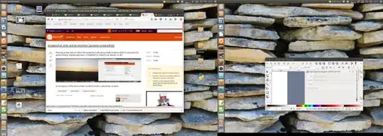

Pressing printscreen or clickin the screenshot will capture both screens, what if I only want the active monitor display captured, is it feasible? Or should I use shutter or sth?
So not spaces of the same screen, but dual monitor system two screens.

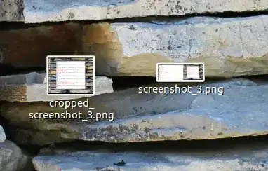

  • automatically create a (numbered) image in an arbitrary directory

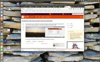

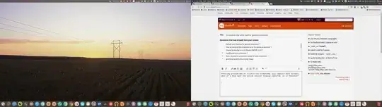

  • automatically crop the image to the section of the screen you are currently on (retrieved from the mouse position), and create a cropped image named:
To prevent overwriting earlier screenshots, these cropped images are numbered like their oroginals.
screenshot
if I am on the left screen:
if I am on the right screen:

  4. Test- run the script from a terminal:
    python3 /path/to/crop_screenshot.py
    The result:
