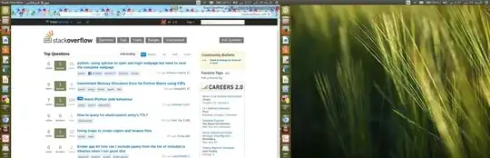

When I press the "Print Screen" the output captures both desktops instead of one!
This problem existed since I updated to Ubuntu 13.10.enter image description here
Update: I opened "Displays" from "System Settings", and found "Built-in Display" and "Unknown Display".

In order to have the screenshot of one display, the "Unknown Display" should be turned off from the Display window which can be found in "System Settings".
