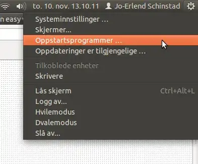

For adding applications to autostart you can use Startup Applications. Of course there is not a ready list for that, you should know the name of the application, more accurate "the starting command" of the application.
