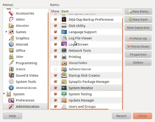

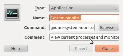

Click on the Main button (top-left corner) and type Main menu and click on Main menu. There browse to where the application is and find select the application you want to find the name for and click Properties. The name of the application is present in the command section. Main_menu
launcher_properties

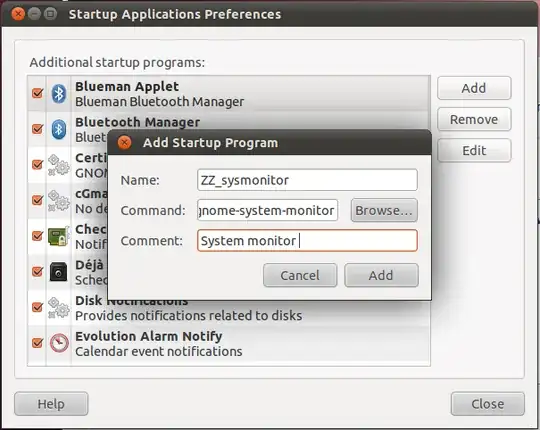

After that, click the main button (top-left corner) and type and click on Startup Applications. There click Add, type a name of your choice and then in the command - put the one that you copied/saw was the name of your application and click add again. And voila! Everything's done.
startup_screen
