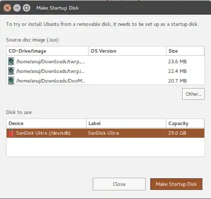

I have sandisk 32 GB USB partitioned in two partitions. Both are FAT32 format and first is 20 GB and second partition is of 10 GB.
I use 1st partition for file storage as it is detected in windows and 2nd partition is not detected (don't event want to) which I want to create bootable persistent Ubuntu.
While using Startup disk creator in Ubuntu 16.04, it only shows whole USB as a single and there is no option to select from two partitions. Startup Disk Creator
How could I use 2nd partition to create bootable using Startup Disk Creator.

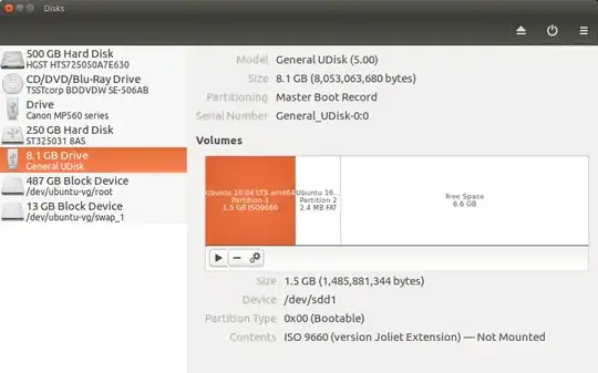

OK, so I created two partitions on an 8gb flash drive, I then put an ISO on the drive using Disk Image Writer Unfortuently it over wrote all the partitions and created this:
After ISO burned
As you can see the ISO takes up very little space including the second partition which I believe is the swap. But it did leave 6.6gb of free space.
My suggestion is that you save the data off your drive, burn the ISO, and then take the free space and make that data space, and move your data back on there. As long as you use FAT or NTFS, windows should not have an issue mounting the drive.
