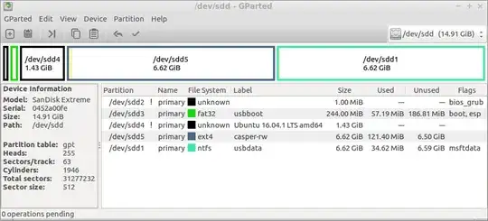

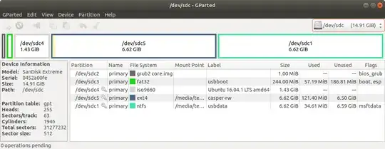

Details
Details about the partitions from and after making the persistent live system:
parted -s "/dev/sdd" print
Model: SanDisk Extreme (scsi)
Disk /dev/sdd: 16,0GB
Sector size (logical/physical): 512B/512B
Partition Table: gpt
Disk Flags:
Number  Start   End     Size    File system  Name     Flags
 2      1049kB  2097kB  1049kB               primary  bios_grub
 3      2097kB  258MB   256MB   fat32        primary  boot, esp
 4      258MB   1791MB  1533MB               primary
 5      1791MB  8902MB  7111MB  ext2         primary
 1      8902MB  16,0GB  7111MB  ntfs         primary  msftdata
lsblk -o MODEL,NAME,FSTYPE,LABEL,MOUNTPOINT,SIZE "/dev/sdd"
MODEL            NAME   FSTYPE  LABEL                    MOUNTPOINT  SIZE
Extreme          sdd                                                14,9G
                 |-sdd1 ntfs    usbdata                              6,6G
                 |-sdd2                                                1M
                 |-sdd3 vfat    usbboot                              244M
                 |-sdd4 iso9660 Ubuntu 16.04.1 LTS amd64             1,4G
                 `-sdd5 ext4    casper-rw                            6,6G
</pre>
 Done :-)
The target device is ready to use.
'ubuntu-16.04.1-desktop-amd64.iso'
was installed
gparted in 16.04 LTS not recognizing iso 9660 file system and bios_grub boot image:
gparted in 17.10 seeing iso 9660 file system and bios_grub boot image:
