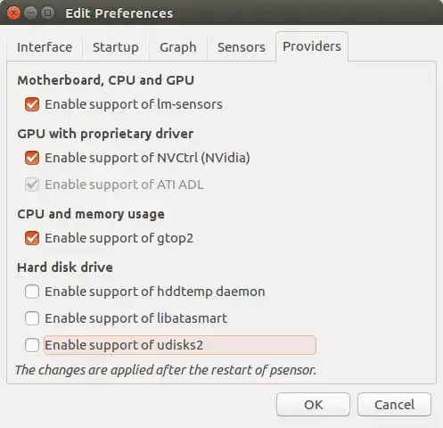

It's caused by lm-sensors. Click on the thermometer indicator (which is lm-sensors) -> Preferences -> Providers. Then untick 'Enable support of udisks2'. That seems to make it go away. (Source)
screenshot

In my case psensor caused the problem. Just kill psensor.
