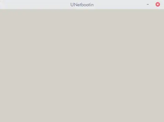

I want to make the switch to Antergos. When opening Unetbootin, I can't open it successfully.
Here is what happens when I open UNetbootin from Terminal:
$ sudo unetbootin
X Error: BadAccess (attempt to access private resource denied) 10
  Extension:    130 (MIT-SHM)
  Minor opcode: 1 (X_ShmAttach)
  Resource id:  0x164
X Error: BadShmSeg (invalid shared segment parameter) 128
  Minor opcode: 5 (X_ShmCreatePixmap)
  Resource id:  0xc0
X Error: BadDrawable (invalid Pixmap or Window parameter) 9
  Major opcode: 62 (X_CopyArea)
  Resource id:  0x2800010
Is this a known issue? Can I fix this? Is there a workaround?

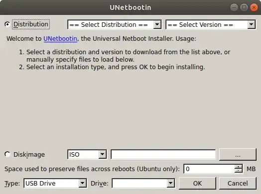

Tried the accepted answer above but still had blank screen on Ubuntu 18.04
What I discovered: As part of the messages in terminal from sudo apt-get install unetbootin I saw the following:
Reading package lists...
Suggested packages:
  p7zip-rar
Recommended packages:
  gksu | kdesudo
My solution: Install gksu
sudo add-apt-repository ppa:belin/stable
sudo apt install gksu
sudo apt update
sudo apt upgrade
Vouila: Fully functioning UNetbootin screen & app
Fullly functioning UNetbootin screen
Warning?: I don't know if I understand all the ramifications of installing gksu. There seemed to be MANY update and upgrade dependencies when I installed gksu (all handled nicely by apt). The only thing I've noticed so far since installing gksu is my message windows changed a bit (they look better to me).
