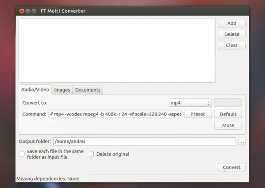

Convert Audio, Video, Image And Document Files With FF Multi Converter
FF Multi Converter supports the following formats:
audio/video: aac, ac3, afc, aiff, amr, asf, au, avi, dvd, flac, flv, mka, mkv, mmf, mov, mp3, mp4, mpg, ogg, ogv, psp, rm, spx, vob, wav, webm, wma, wmv;
Install FF Multi Converter in Ubuntu
sudo add-apt-repository ppa:ffmulticonverter/stable
sudo apt-get update
sudo apt-get install ffmulticonverter

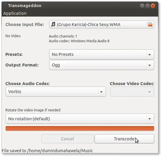

You can convert it with
Transmageddon
Install via the software center
sudo apt-get install transmageddon
